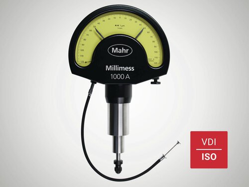

Mechanical dial comparator Millimess 1000 A
Product number: 4338100KAL
Dial comparator Millimess 1000 A
Factory standard
Dial color: Yellow

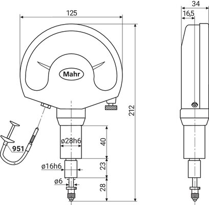

Measuring range : ± 120 µm
Readings (µm): 1 µm
Measuring force: 3.5 N
Package contains: cable release, test certificate, case

  • Very clear, reliable and fatigue-free readings due to extra-large display.
  • Ideal for test stations at which high volume production parts are measured or where the display can only be read from a distance.
  • For use in a stable measuring table. We recommend: MarStand 824 GT measuring table
  • M2.5 thread on end of measuring pin for optional standard anvils
  • Large, high contrast dial face
  • Adjustable tolerance markers
  • Lockable fine adjustment screw
  • Shockproof movement
  • Mounting shank and measuring spindle are both made of hardened stainless steel
  • Measuring spindle is mounted in a high precision ball guide for minimal hysteresis
  • Resistant to lateral forces (side play) acting on the measuring spindle
  • Maximum sensitivity and accuracy are ensured by the jeweled movement in conjunction with the precision gears and pinions
  • Box type protective housing
  • Constant measuring force
  • Measuring spindle can be retracted with either a screw in cable release or with a lifting knob
Scope of delivery cable release, test certificate, case
