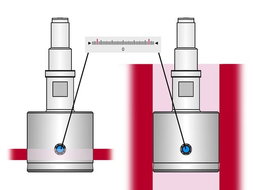

Model for through holes, with extended measuring range
- With extended guide cylinder for measuring through holes from the edge of the hole
- For the rapid testing of diameter, roundness and conicity of bores
- Especially suitable for testing batches with wide tolerance zones
- Rocking in the bore is not required to determine diameter
- Ideal for use in conjunction with digital display units and for subsequent processing of measured values
- Measuring head has a hard, stainless cylinder guide and carbide-tipped anvils
- The carbide expanding pin transfers radial movement to indicating instrument
- Extensive modular system is composed of measuring head, holder, depth extension, right angle attachments and depth stops
